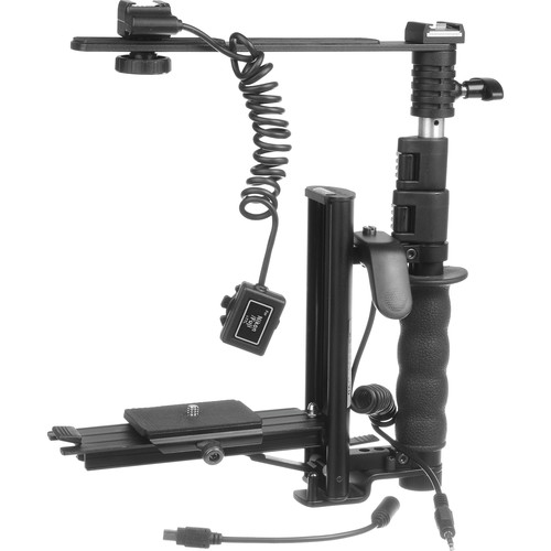

Been thinking of getting a flash bracket to raise my flash off of my camera.
I read that being able to flip the flash or rotate the camera is a good idea so that the flash is on top of the camera regardless of orientation.
I also have read that all you need to do is always shoot landscape and just crop if you want vertical portrait image and spend your money on something else. (see Phil V's comments at
http://www.talkphotography.co.uk/threads/flash-brackets-for-wedddings-events.507542/#post-5832975 ) Yet there are many who recommend getting the flash up off of the camera.
Based on what I've read it would seem best to get the flash up more than just a few inches off the camera so I'm inclined to look at units that offer up to about 18" (the Morris even goes to 28").
I found B&H a good source for these items, all the links go to their website.
They offer a Manfrotto 233B for $81 US$
http://www.bhphotovideo.com/c/produ...3B_233B_Telescoping_Camera_Flash_Bracket.html
I'm confident that Manfrotto quality would be good. It does look well machined. It does allow the user to keep the flash overhead but apparently not as smooth and easy as the other's in this category.
RPS Studio offers a Dot Line RS-0420 kit that comes complete with cables (iTTL & shutter trigger). They have a good demo video on their website. $108 see
http://www.bhphotovideo.com/c/product/632477-REG/Dot_Line_RS_0420_D90_RPS_Digital_Flash_Bracket.html There are two models, this one and for $20 more you get one where the flash bar rotates (called Bounce Control). B&H also offers a Morris version that look identical to this one, but it does not come with the same cables. (Cables would cost about $20-$40 depending on quality).
http://www.bhphotovideo.com/c/product/635027-REG/Morris_32301_Vertical_Horizontal_Flip.html
My inclination is to go with one of these:
I do read many recommendations for Custom Bracket products but they are considerably more costly (closer to $200) - I could buy an older version for about $100 but then still need to buy adaptors and plates as these are not included, plus the cables. Seems there cheap ones that just raise the flash a few inches above for $20-$70 then the ones like those above, then the professional grade ones for $200-$400. Custom Brackets does offer a less expensive Junior kit for $105 at http://www.bhphotovideo.com/c/produ...ets_CBJUNIORKIT_CB_Junior_Flash_Rotating.html I suppose one could mount an extension on top of this unit if you really wanted the flash higher - but then you could not 'flip it" properly. It has many good reviews.
Any thoughts on the idea of a Flash Bracket - and which type / model to you recommend?

I have that Manfrotto bracket (don't use it any more) and also the one illustrated, but it's highly modified - only using the grip and extension - not really relevant here. Note that for shooting verticals it rotates the camera clockwise, putting the shutter release at the bottom, which is not where you want it.

Nevertheless I must confess to being a bit of a gizmo junkie and I found an eBay deal I did not let go - I bought a Newton Di100CR http://www.newtoncamerabrackets.com/new_page_5.htm
It retails for $269 - my eBay buy included a Nikon SC-28 and the bracket for $72. Yes wireless is the way to go, but given it was included for now I'll take the SC-28 (which retails for $64). So dollar wise a great deal - now will it improve my photography? We will see. I like the craftsmanship in this bracket, Newton is a one man company in the USA. When I researched it I found it is a very small co. but those who like it, like it a lot. It is well made. I'd never part with $269 for it, but for $72 with the Nikon cord I think it was well worth it.
