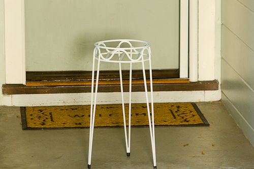

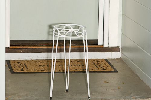

This photo series illustrates that a 5" x 7" sofbox does little to soften shadows, even at 20' distance from light to subject.
While a 16" x 20" softbox soften shadows considerably, even a 20' distance from light-to-subject
My guess would be that the environment is doing a good % of the softening in this scenario. I’d never use a softbox from 20 feet away, let alone a 16 inch one. We can see the white wall to the right, my guess is the left wall and ceiling aren’t that far away.
The rule of thumb for a softbox to be soft is for the subject distance to be no more than the diagonal of the front face of the softbox.
Portraiture 'soft' is different from wedding/event coverage...those of us who have covered weddings use different techniques/equipment to reduce or eliminate visible'distracting levels of shadow shadowing behind the main subjects, and we do not have the luxury of placement of sources at portraiture-close distances. Ergo, my demonstration of 20' shooting distances and how negligible the beneift of using the tiny (4x6 or 5x7) softboxes marketed commonly (in reposnse to this inquiry about using small modifiers). My shooting medium format using a Metz potato-masher style flash perched above the lens axis permitted my shooting with a 16 x 20" softbox without blockage of the lens view. So yes, 16 x 20 is certainly not 'large' in a portraiture standpoint, but it does reduce evlidence of shadowing significantly.
At about 2-3X the diagonal, a softbox starts to make a transition from being s soft (a.k.a. 'large') source, and its transition from Inverse Linear to Inverse Square rule of light intensity falloff But as my example showed, even at 9x the diagonal, there is evidence of shadows but they are quite soft in the penumbra quality...something very desirable in event coverage. We can reserve the really large sources at 1-3X diagonal for the portrait sessions, and use other tools for the event coverage (which is the reason behind this thread topic use of otherwise tiny modifiers!)
