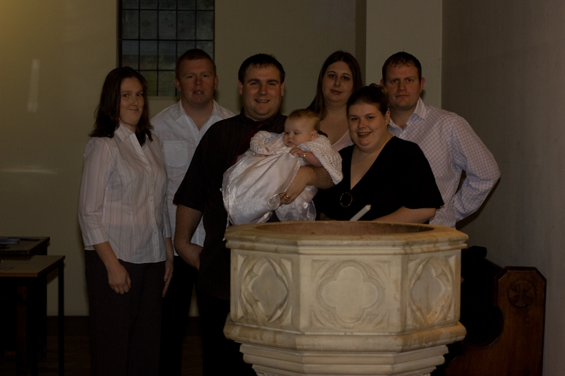

Here you go. An example. The light that you can just about see coming from the right is a small wall lamp that was illuminating a picture above the font.
I think the EXIF is still intact. This is an export to jpeg from the orginal RAW file. Just resized to 800 pixels
1/60 @f4.0
ISO 400
50mm f1.8 Lens

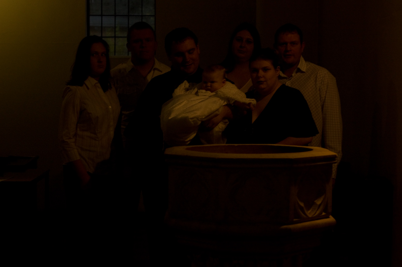

This was taken 1min 1 sec after the previous shot (which came out OK ish) according to the exif data
This was taken 4 seconds later (the flash ready light was on again).
Still not spot on but a lot better.

I can't see any obvious reason for such poor results from the flash, in those shots even the onboard unit would have coped. I would suggest taking the unit back and comparing it to another unit as I think you've got a duff one :(
It doesn't look as if the flash fired on the dark shot...or if it did with VERY little power. You won't notice the power difference by eye unless you are looking for it (at time of shooting).
If those two were 4 seconds apart, then the flash might not have fully recharged....possibly a dirty contact causing intermittent firing. At least that last shot is salvagable.
