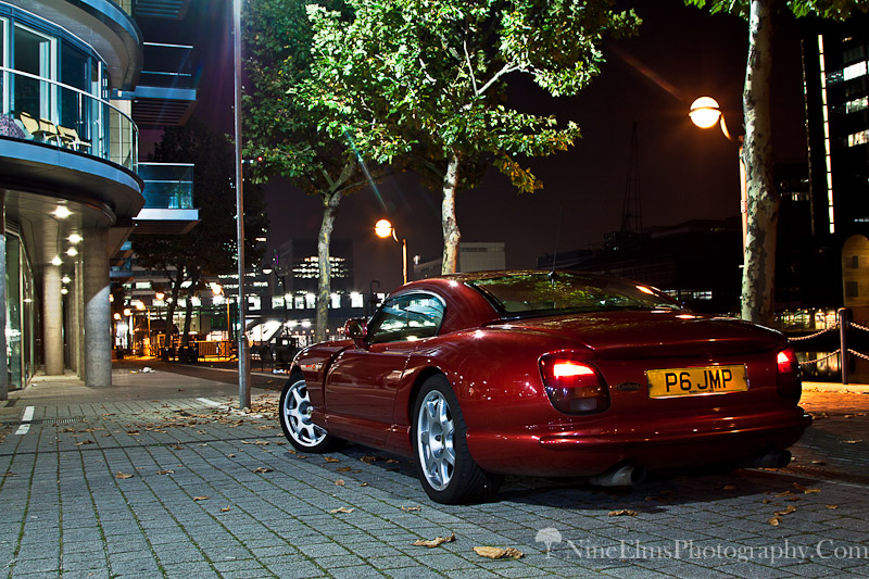

Are these any good, do they work and if so what's recommended.
I've been shooting my car in various night time places and want to minimise the effect of the flashgun in the bodywork.
Some examples to explain what I mean.
worse still
I was out without much kit, uses multiple flashes from one flashgun to light the car but they've left reflections of the source all over the bodywork. I think I need something to soften the light thats small, compact and light that will fit in my camera bag.
Any suggestions?

Light softness is directly relative to the size of the light source. Even with one of those, the light source is tiny in comparison to the subject.
Get yourself a westcott apollo soft box that goes up like a brolly. The flashgun fires into the rear and the light spreads out evenly to give you a nice large soft light source.
28" apollo is your friend here :thumbs:

usually I use a polariser, and did on shot 3. Shot 1 & 2 I didn't as I liked the reflections in the window.
Strobist site is full of good info, but I guess i was really asking if the small flash modifiers were any good.

Hum interesting. Is there much advantage over shoot through brollies?
£100 price range means it'll go on the wish list, but I like the design.
Reflections I can live with if they are large and diffused. It's the sharp impact points that spoil it.

I would say its not worth it. To make soft light you need to increase the size of the light source. That doesn't really increase it that much, and also there will be a hotspot due to the forward firing head.

The professionals do it with with huge great banks of light. Like a load of massive scrims with multiple heads firing through them. Then pp over the joins.
I've had decent results firing a gun repeatedly around the car, just as you have already done, then cloning out the hot spots. You can do it like that at night as you don't need to battle the ambient. Can't you just clone out the hot spots?
Sometimes I quite like to leave them in. I discovered, by accident, that if you fire the gun consistently, ie same height and distance at regular intervals, that you can make quite attractive lines out of them!
It's like a MUCH smaller Apollo ;) Where small = bad in this case. Useful in a pinch for portraits or softly lit macros. Very close to useless for this application.

Yup, another learning curve. I was driving out of canary wharfe, saw the location, tried the shots. Lots to learn there, but that's part of the fun. Instead of PPing out the hotspots I may just straighten then and extend them along the line of the car.
It was a last minute decision to take the shots, based on an early arrival and time to kill so I didn't have a lot with me. Next time I'll take a little more.
I've another shot of outside my house using 22 layers and 4 flashguns on a lighting stand where I've moved around the car. In this case the flashguns were at a fixed height. I suppose I could keep the flashgun around waist level to keep it at a steady height in the canary wharfe pic.

Yup - thanks all I think you've dissuaded me. I really appreciate your input.

Thanks all - big umbrella softbox it is then. It's something I can use with portraits as well so won't be wasted. Looks like Karlu has them at a reasonable price. Just need to smuggle it past the financial controller (missus). ;)
Don't know what anyone else thinks but my opinion is the photos are superb. If I could get shots like that I would be well happy. Problem is getting "er indoors" to polish the car first.

Thanks, it helps having a fibreglass car. The gel coat is always shiney, the car itself was quite dusty.
Shot as part of my last assignment (or bits of it). I might put the post up in transport
