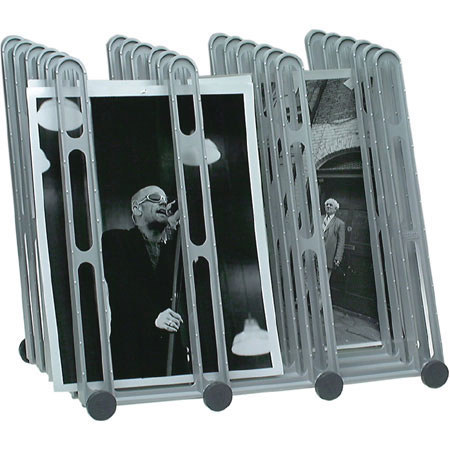

I have a peterson rack for drying, one of these
But I don't think it's the best thing really.
I haven't much room to make/install a rack with screens.
Do the two sheets not stick together when you dry them one on top of tother?
They stick together at first, yes. That's the whole point of it. They come loose as they dry, and so don't start to curl until a lot later on in the drying process. I imagine you could do it with that rack thing, just slot them in back to back. I don't know, I've never used one, but it's definitely worth a try :thumbs:
