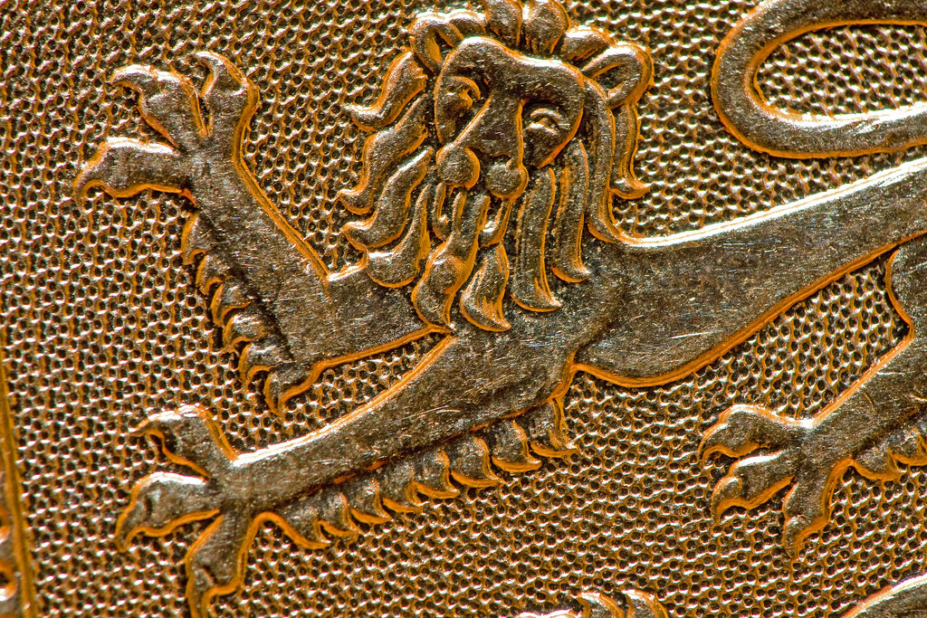

This is a shot i have taken with my 100mm macro with a raynox 250.
I have only just got the lens (£42 from amazon with free postage) so not had time to put it to a proper test yet, but it will give you an idea on what i have got with first crack at a 10p
golden lion by bx338, on Flickr
Its only my first try with it, but my initial thoughts were good, i hope to try it soon in natural light to see how it fairs up.

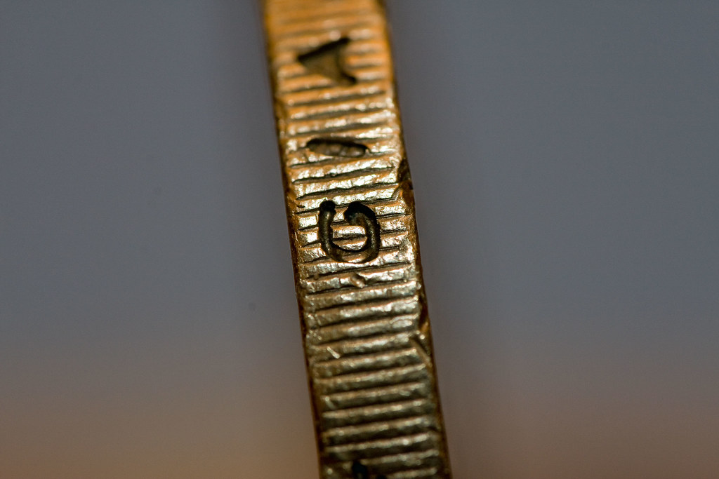

This is another shot of the edge of a £2 coin.
IMG_9720 by bx338, on Flickr
