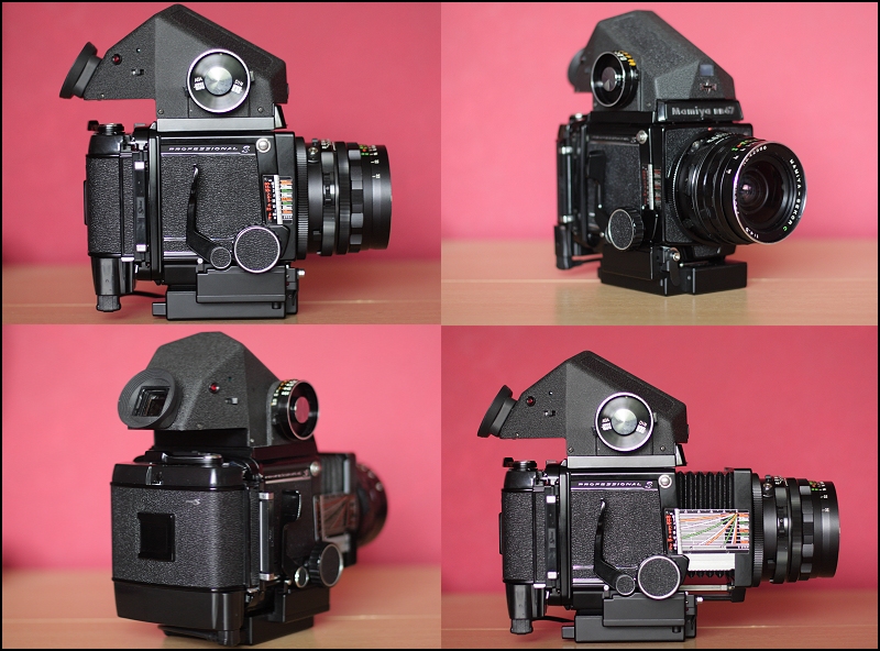

Hand holding the RB67 with CDS prism finder is a PITA...I had to put the L frame back on which made it even heavier and bulky.
If anybody wants to see a snap of it all let me know and I'll post it.
Here's one I did earlier.
RB67 by tonky8203, on Flickr
I don't use an L grip, but I do sometimes use a big old hammer head flashgun which provides a similar grip on one side. The original prism shown in the pic does add significantly to the weight of the camera, but I still find no problem using it at eye level
What you don't want to be doing is trying to support the camera at eye level with one hand while you mess about trying to balance the viewfinder display with the other - that way lies madness!
For eye level shots I'll take a hand held meter reading (or use another camera for the reading) before I pick up the RB - then set the correct exposure on the RB at waist level.
Then it's quickly up to eye level supporting the camera with one hand cupped underneath- a quick focus adjust with the right hand, then take the shot.
Works for me.
The power winder fitted under the camera in the pic is hardly ever used I might add.
Nice shots, but would be better with a OM10 along side to compare :)
But I've put the "cheap no name" L grip on the left side (looking from the back) which works out quite nice as the base of the "L" grip extends out to and under the focus knob and shutter button and I can rest my R hand underneath for extra support and operate the controls (focus knob and shutter button).
