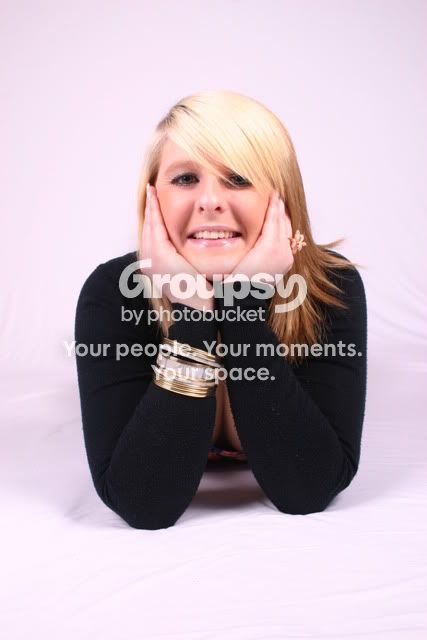

hi, im new to studio lights. im using the interfit ex150 lights. As im new to this i got the cheap lights lol. Iv also invested in a collapsible white background with a 7 ft train on it. Iv positioned one light (soft box) on the corner of the end of the train and on the other end of the train iv postioned the white umbrella light. Problem is the white background is showing up lilac! iv had some friends round this afternoon and iv taken some pics of them for some practise and on my lcd screen on the camera the pics are really nice. Then when i transfer them onto my comp, the back ground is pinky/lilac. It shows up more on the right hand side (the umbrella side). Iv tried everything i can think of....reposision the lights, adjusting my aperture, adjusting the lights strengh and it wont go :( anyone got any ideas?? i would be very very grateful x

ill see if i can attach another one because this one doesnt seem to show up the lilac very well.
this one i took of my friend earlier
so it cant be that my moniter is out like hodders said because you can see it. The instructional DVD that came with the lights said to set the WB to flash. Iv also tried it on AWB and doesnt make a difference :( Do you think that just having 2 lights isnt enough then? on some of my pics the pink trails all the way down the train too, not just on the background. Im really stumped as to what it is.
yes i know how to set up the WB. its on flash at the mow as per the flash instructional dvd but i have also taken pics in AWB and still shows up pink. Im using GIMP at the mow for editing software, im told its the closest to PS.

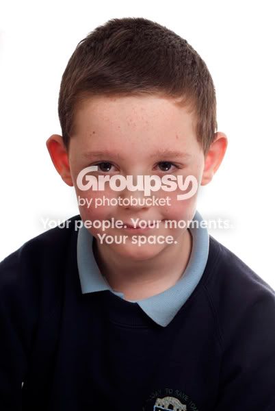

I have the ex150's too, took this straight off the camera using off camera flash on the backdrop.
hi lee, so did u have one light on the BG and one light on the subject? or did you have both of the ex150 lights on the subject and 2 separte lights on the BG? I got both the lights on the corners of the train which is about 7ft away from the main BG, pointing towards the BG. I have my camera setting on 1/125 ISO100 F.8. I think having extra lights on the BG will help but i dont know how it can help with the pink on the train. Ill try the custom white balance too.

My guess (and it is only a guess) is that although there is an obvious white balance issue there is also colour polution from the ambient lighting. The colour polution shows up more in the area that is not overexposed, that's why it isn't as bad in the area on the left of your background.

Your images are also lilac on my monitor so it is not your monitor colour profile. I'm guessing that they look OK on the camera screen as the screen is only small and not that accurate.
