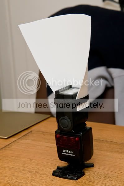

I was having a real Blue Peter moment last night making my own flash diffusers. It was inspired by the Better Bounce Card and to make it I got my self off to Hobbycraft in search of my materials. I was thinking of using thick paper but in the end I opted for a product called Fab Foam which is about 2mm thick and comes in A4 and A3 sheets, the A4 being 49p.
Once at home it was a reasonably simple matter to cut it to shape and fix to the flash head with a strip of velcro.
Here it is attached to my SB-600, when in use you can have it either facing forward or backwards, by using it backwards you will get a spread of light plus retain a catchlight.

Does it not depend on the properties of the material you use... as to whether it absorbs lots of the light or bounces it? Id have thought foam would absorb it... but the photo of your lad looks good.
Does this mean putting a much more powerul output on the flash as lots will be lost in the extra distance of the bounce and the foam?? ie, not using ETTL

The foam is very dense Janice, it's almost like a thick piece of pliable paper and it won't absorb the light, obviously because it is white it will reflect it. By pointing the flashgun straight up it scatters the light everywhere giving even coverage.
On the shot of James the flash was set to TTL and no extra EV compensation was added unlike the Lightsphere which is usually at +2 EV.

The colour is the main factor. The "softer" the surface the more the light will be diffused and so less will reach the subject but the effect of that won't be nearly so noticable as the brightness used. A very smooth and shiny grey card wouldn't be nearly as efficient as a sheet of white paper or foam Colin used.
ETTL will compensate for the bounce, the pre flash calculates the power needed for the main burst. In manual mode the same would be true if using a meter, or even chimping the histogram. You will lose a fair amount of power tho probably around 2 stops in an average situation.
