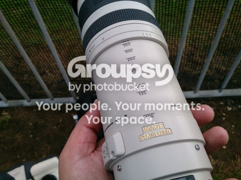

So today at Duxford and I finally start to see the paper gasket thingy shredding and falling out the back of the slide. This is my favourite lens but now that the seasons over won't be getting much use. Whats the general opinion do I send it back to Canon and how much am I looking at?

Send it to Canon it's the friction ring breaking up.

Thanks for the replies. I sent an email off to a Colchester Camera Repair - a Canon repair center listed on the Canon website and got this response:
Thank you for your query.
To supply and fit a replacement friction ring only, will be £40 labour, £28
part, plus VAT and postage. To service, calibrate, clean, check and replace the
friction ring will be £130 labour, £28 part, plus VAT and postage.
