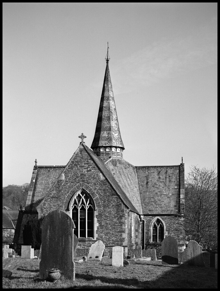

Shot with 65mm GX-M at 1/60th sec, f22, yellow filter, slight rise to lose some gravestones.

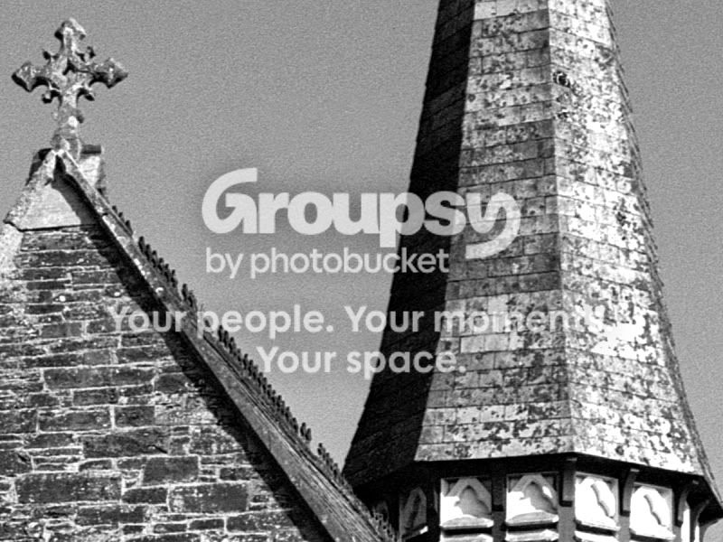

100% crop of 65mm image 2400dpi
Shot with 125mm GX-M at 1/60th sec, f22, yellow filter,

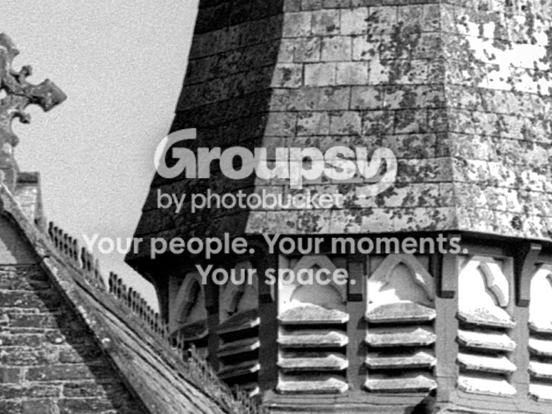

100% crop of 125mm image 2400dpi
