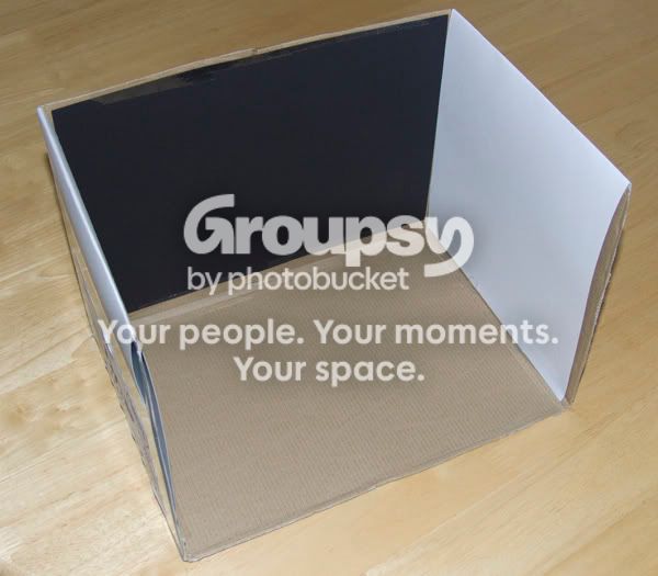

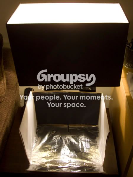

Main Box
1. A4 copy paper box.
2. Cut out front of box.
3. Cover sides with white card/paper, sellotape into position.
4. Rear of box is your background colour, I generally use black card.
Picture of main box

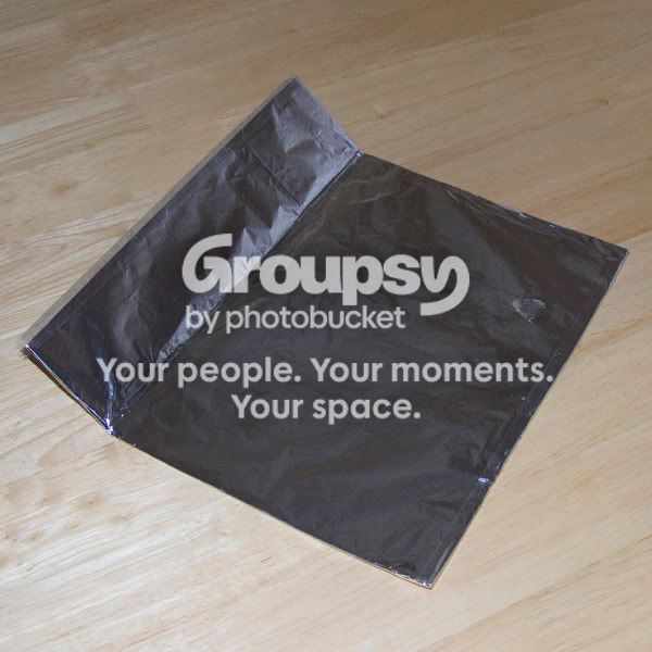

Base
1. Cut from lid of A4 copy paper box.
2. Cover with Baco Foil, sellotaped into position.
3. Note angled piece at front, this surprisingly does reflect additional light onto the subject.
I made the base separate as the foil may get damaged and will be easier to replace. I also want to try different reflective media, gold foil etc, to see what affects this may have on the lighting.
Picture of Base

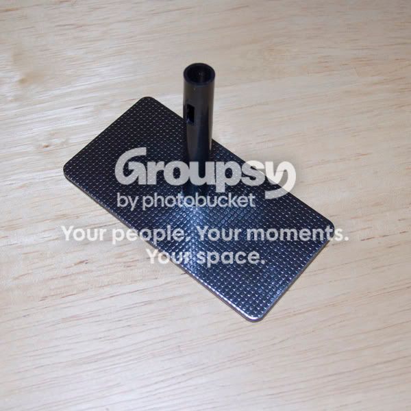

Flower Holder
1. I glued together 3 metal finishes samples to form the base, (obtained from work). Whatever you use needs to have some weight to it to make it stable.
2. Black tube, cut down body of plastic propelling pencil, approximately 50mm high. I specifically wanted black as that is my main background colour.
3. Super glue tube to base.
Picture of Flower Holder
Picture of Assembly

I position the box under a table lamp, 40W bulb.
All photographs are taken late evening whereby the table lamp is the only light source.
Tripod and cable release are essential, (or timer on camera if you don’t have a cable release), as exposure time is usually between one to two seconds depending upon the subject. The lighting is quite subtle hence the longer exposure times.

So pardon me for being thick but in the assembly picture is the black box with the light out of the top the table lamp?
