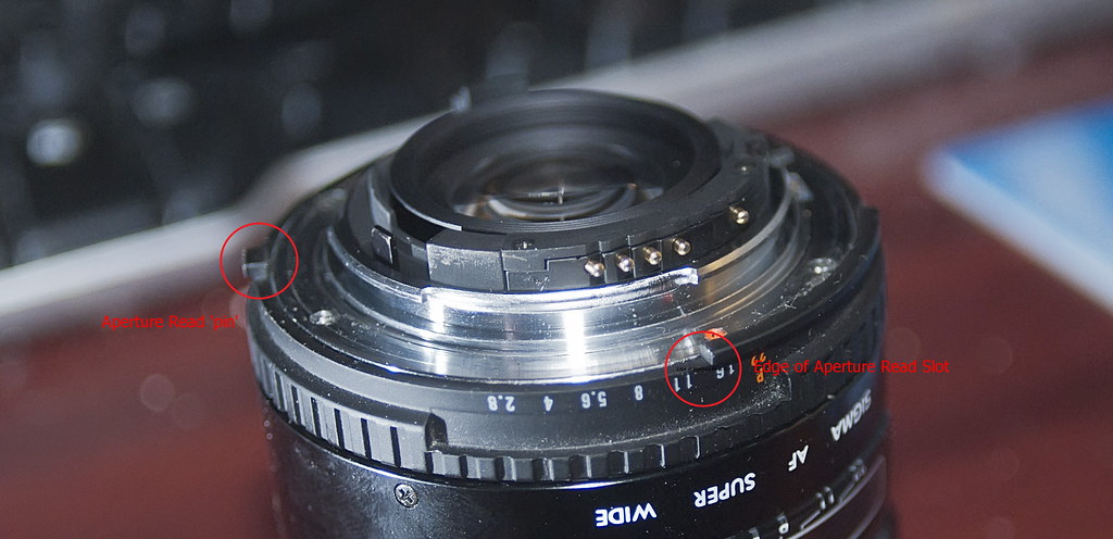

Here's an image that has the edge of the Aperture Read slot and the Aperture Read pin (which the Aperture Read Lever on the body pushes up against). This is on an oldish AF lens, which has the 5 contacts for a basic AF function, but nothing more fancy.
Aperture Read items on Nikon AF lens by nikki_archibald, on Flickr
