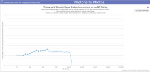

This chart shows the benefit (difference) that changing the ISO provides. While it's not entirely flat (ISO invariant) it's bordering on being nearly imperceptible (≤ .5EV).
Used w/ permission; link-
