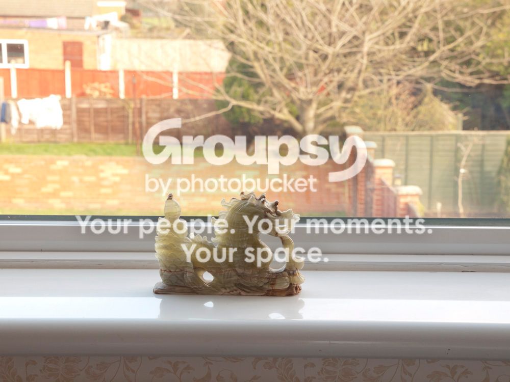

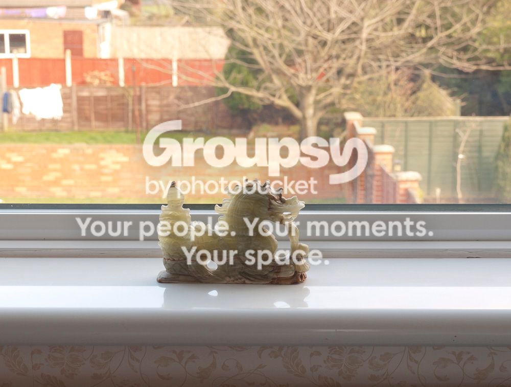

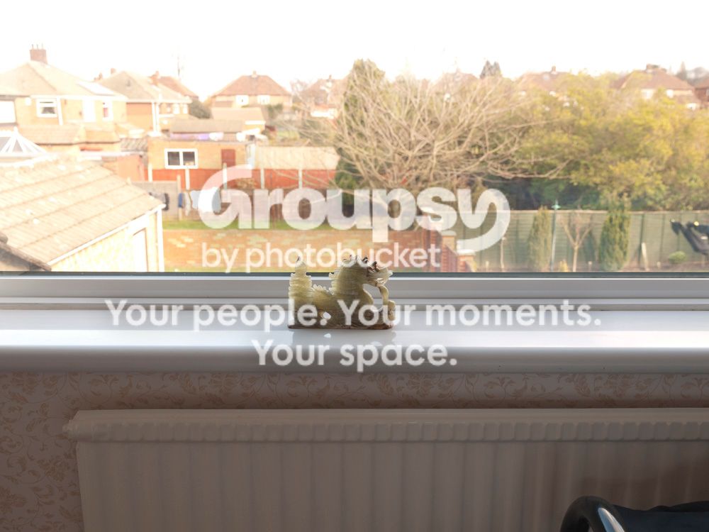

Here you go. A Chinese dragon against the outside world including the neighbours washing :D
This is MFT at 17mm f4 and 35mm f8 for full frame equivalent of 35mm f8 and 70mm f16.
35mm f8 whole image shot...
17mm f4 shot but cropped to 35mm field of view...
17mm full image...
Hopefully you can see that at the same distance if the crop factors are accounted for the pictures will look the same (excepting resolution...)
Therefore 35mm on APS-C will look similar to 50mm on FF and the only differences should be down to differences in lens design and construction.
