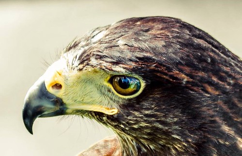

Same lens - different location, probably 4 metres away from this bird but look at the clarity in the difference, hand held too.
Untitled by Pixearl Photography, on Flickr
