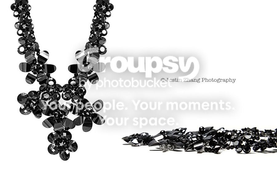

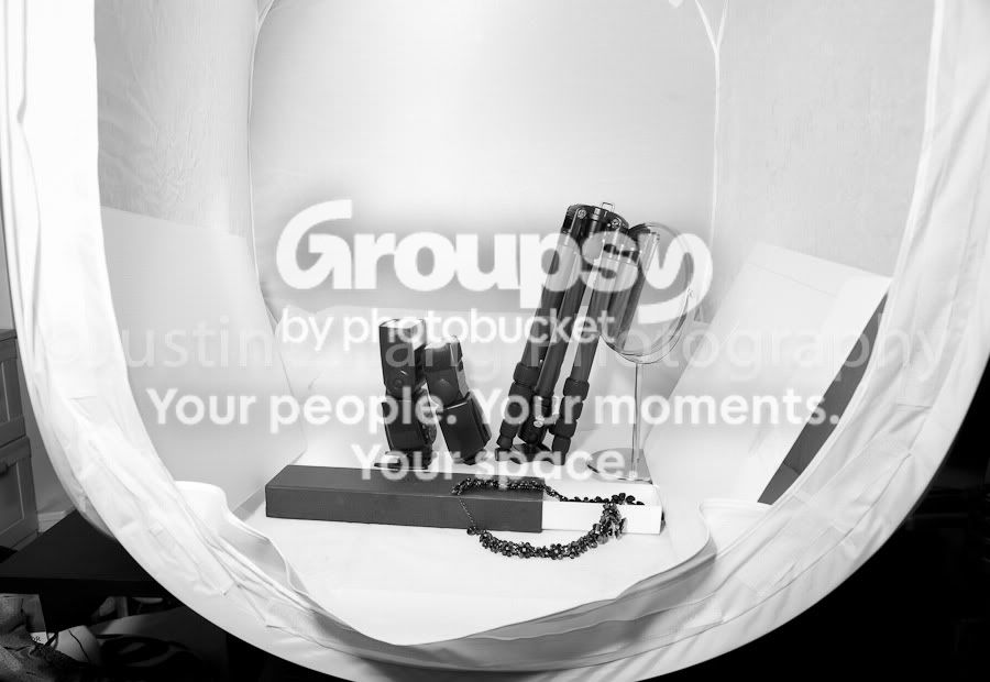

Here is a sample of my work (not professional setup but for fun) using 5d Mark ii with 24-105 lens with two small flashes.
my website: www.justinzhangphotography.com
