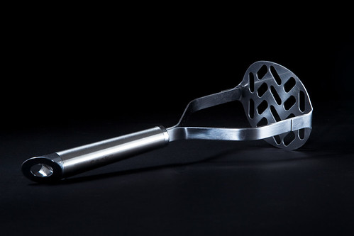

FWIW - I was trying this out with a similarly shiny, metal, curved object at the weekend. It took 3 separate light sources to shoot this:
