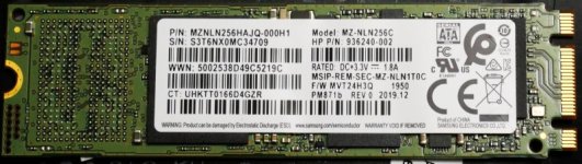

One of my laptops (HP 255 G7) has this SSD

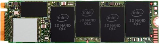

Can I replace it with this SSD
M.2 PCIe 3.0 x4 (NVMe)

the one at the top is an m type SATA the other is a nvme

The one at the top from your laptop has two cutouts on the right of the image that slot into the motherboard housing.
The one you are buying only has one, left side of the image.
The new one will not work, its as simple as that as it will not physically fit into the slot where the old one was.
Why not?
There is only one key on the motherboard, so it will physically fit.
Yes there are two key slots on the old SSD, but nothing goes into the B slot.
I should have rephrased my answer above when I meant physically fit.
This might be a better answer.
NVMe drives rely on having a direct connection to the PCI-E bus and cannot connect to a SATA hard drive controller. Therefore, an NVMe drive will not work in an M.2 SATA slot, even though it will physically fit if it is an M-keyed slot as opposed to a B-keyed slot.
