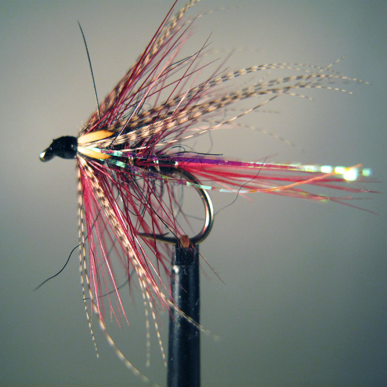

The autofocus is working OK. The problem with it is that it is focusing at what is just an inch in front of the camera at f2.8 and picking parts that are not what we want it to focus on. Here's one I did myself with a Canon G10 that illustrates the problem...
The AF is picking out the black fibres. Our eyes are looking for the hook to be in focus and it is lying behind the focal plane. It is not problem to do with any camera that has manual control, but P&S cams struggle with the job.
