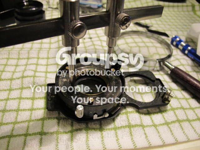

Some may have seen my previous post , I have taken a brave pill , Ordered some special tools , So here we go

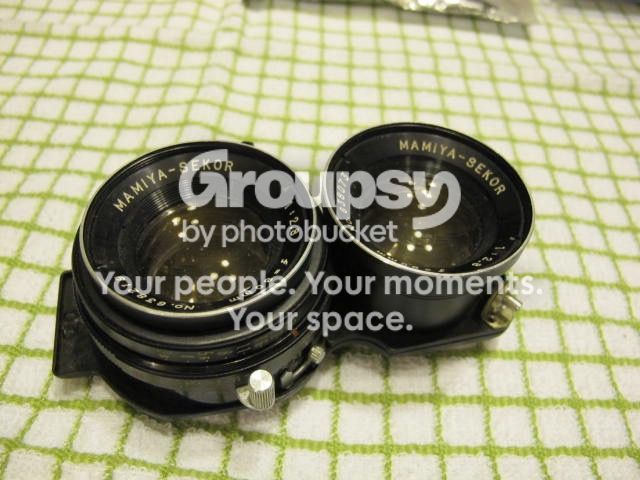

Tese are the component parts when I dismantled the camera

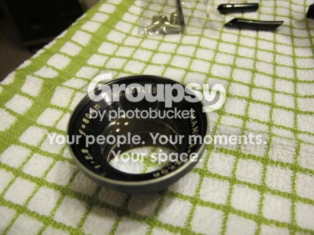

The faulty lens

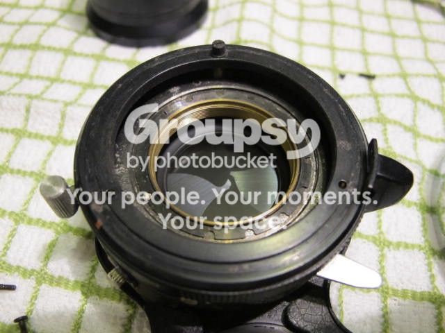

One lens out, the taking lens
The internals with the lens removed

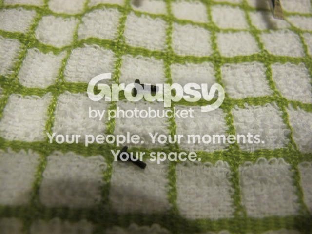

The 2 screws that were rattling around inside the lens
You can see the one screw in place at the top and the 2 missing screws one at 8 and one at 4 o'clock

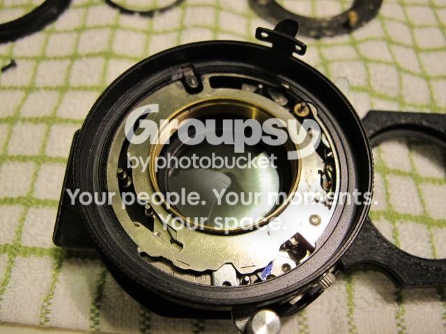

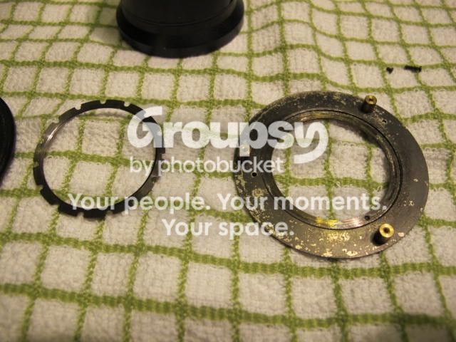

I needed to remove these parts to get access
some really tiny and I mean tiny screws like pin heads , I had to pick them up with tweezers they were so small
The shutter speed mechanism
And the special tool in action
