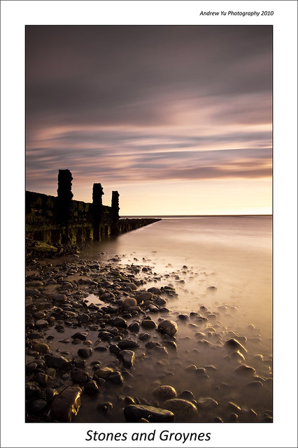

Some pictures using the Hitech 0.6 ND grad Hard edge filter in conjuction with the B+W 10 stop filter:
And this picture was using the Hitech 0.9 ND filter inconjuction with the Hitech 0.6 ND Grad Filter:

Why did/would you use the pure ND on the walkway one to slow down the exposure? No real water to blur there is there? Just interested is all!:thinking:

I used the pure ND filter just to increase the exposure time to get some slight motion blur in the clouds, a subtle effect, but if you look at the cloud texture i think it is visible.
