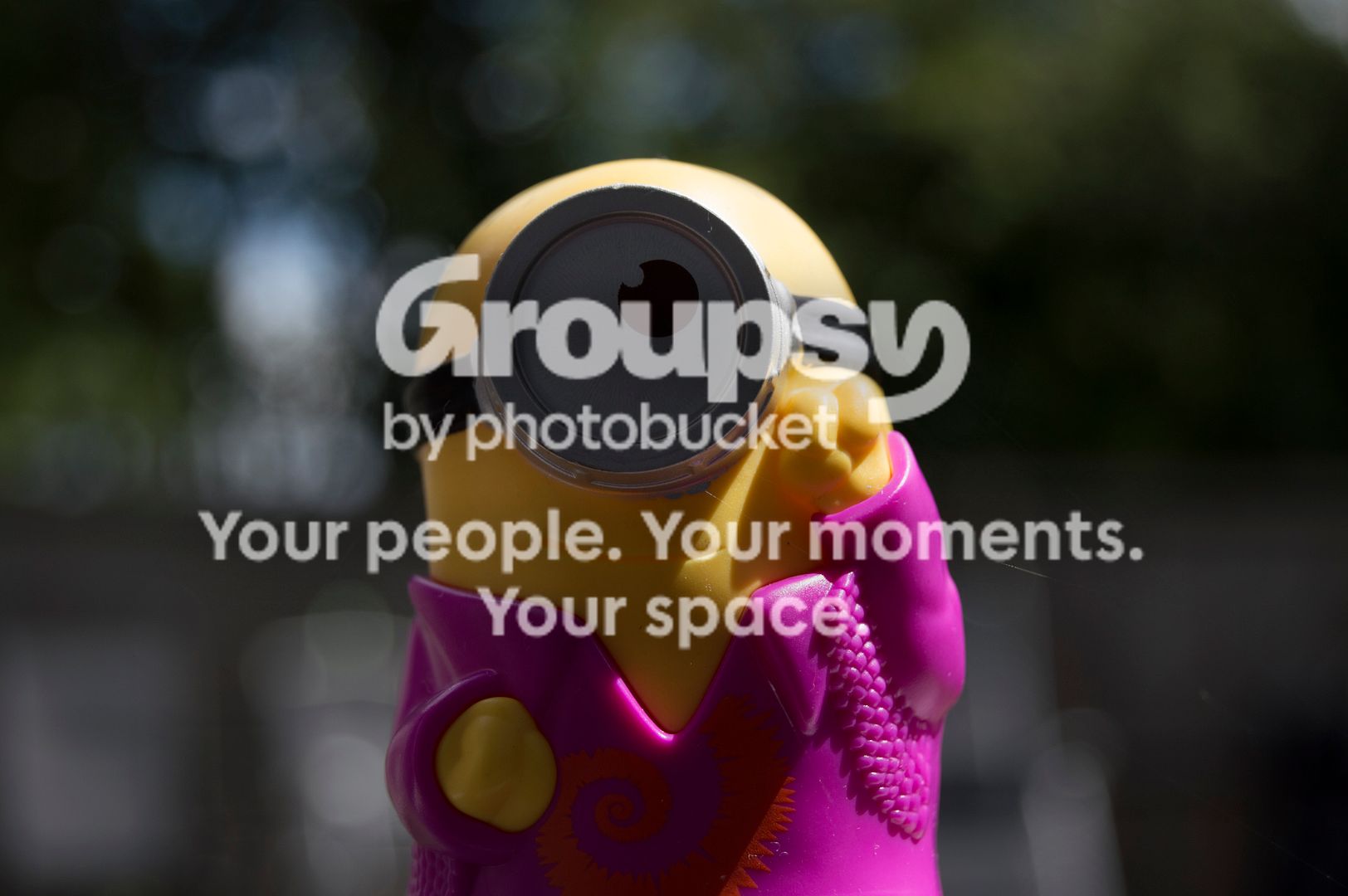

Oh yes, that is exactly what I'm after! I can't upload the ones I wanted to, but I can upload this one which kind of shows what I mean about the image not being sharp and looking kind of flat. Hopefully someone wont mind pointing out where I'm going wrong.

Nice one Kate, you're well on the way! You could get a little bit tighter and remember the golden rule with photographing anything that's alive; focus on the eyes because that's where the soul is.
Yes, lighting wasn't great here, it was a bit of a grey day, but then I have this issue even on a nice day. I always try to focus on the eyes, but they come out not quite in focus. Maybe I just need to work on that, I don't know. I didn't have the problem focusing with the kit lens though. Hmm.
Wow, ok, nice to see what can be done with the lens when you know what you're doing! I don't believe I do, my Grandad has about 30 Canons but not a Nikon. I think I'll get the 12 year old to stand still for a bit and let me take some shots and see if I can nail it with a less wriggly subject. ;)
