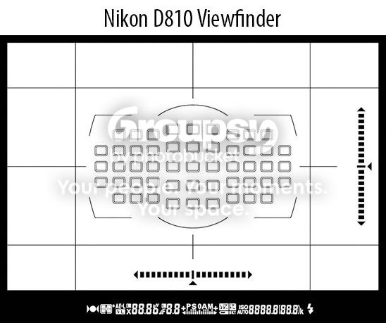

Here a image of the viewfinder icons Bill, this may help to narrow down what it is you seeing?

this is what I seem to have
the ? and the 0 are quite faint
That is strange because in theory the highlighted picture shows all the options available on the screen so I can't see where the ? symbol is coming from unless it an error message or something for diagnostics by Nikon?

(the black rectangle is half the size of my illustration) .... just reposted the above image to show true size of black rectangle
I have the usual info a the bottom of the VF
I cannot find it at all in the D810 Manual or by searching the web
No it very weird as I had a google about as am sure you have and can't find any mention of a ? symbol anywhere? I am intrigued now what it can be but it certainly not something can find any info on at the moment?
Thanks Mick
It is odd as you'd think any possible display would be in the manual, if only in the troubleshooting section. There's no mention of it here either by I can only assume it's a fault. I'm intrigued to know what it is and why Nikon thought it wise to omit it from the manual.

It's not a crafty hair or fibre (impersonating a '?') within the viewfinder/mirror area itself is it?
Must admit, the thought had crossed my mind also. Check your focusing screen Bill. Give it a good blow with a rocket blower.
good blow with a Rocket brush and it's gone
as you both said ........ but I still could not understand the small black rectangle unless there was also a little dirt
