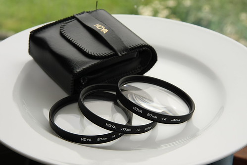

So they're better than the close up things....
See post #12 on this thread http://www.talkphotography.co.uk/forums/showthread.php?t=177413
Exactly the same principle as those Hoya close-up lenses, but stronger. DCR-250 is +8 diopters, 3 elements, and fully coated optics. DCR-150 is +5.8 diopters (same magnification as +4 and +2 together, but better quality. Don't expect pukka macro lens quality but loads of macro fun for £40-odd quid.
