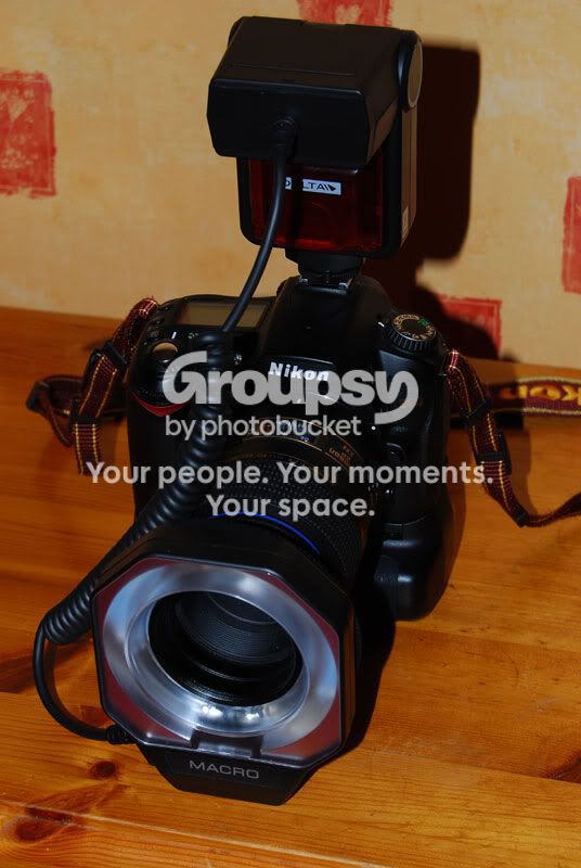

This unit arrived yesterday, so I have given it a quick try out. Here it is on the camera:
It's pretty certain this is the same as the Marumi unit that sells for around £120 from the normal outlets.
Overall build appears fine to me, a number have commented it's very flimsy, I really dont see this. I Used some vapex 2700 batteries and they are a tight fit in the battery box, but nothing too drastic.
Camera compatibility
Nikon D60 - poor, inconsistent triggering, not really usable (update, tried again and its fine!)
Fuji s5 pro - consistent triggering, but spontaneous flashing (update, consistent firing but still spurious flashes!)
Both of these cameras are fine with my Di622 and sb600 so I can only conclude there are compatibility issues
Then on to "old reliable" my D90.
Perfect, consistent triggering better metering than the others and no spontaneous flashes.

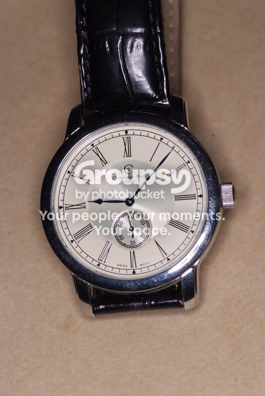

So what about the results? these are quick point and shoots just to show what the unit can do without any form of adjustment:
Verdict: If you have a D90 or maybe a D60, excellent value. It really doesnt like the Fuji at all.................
