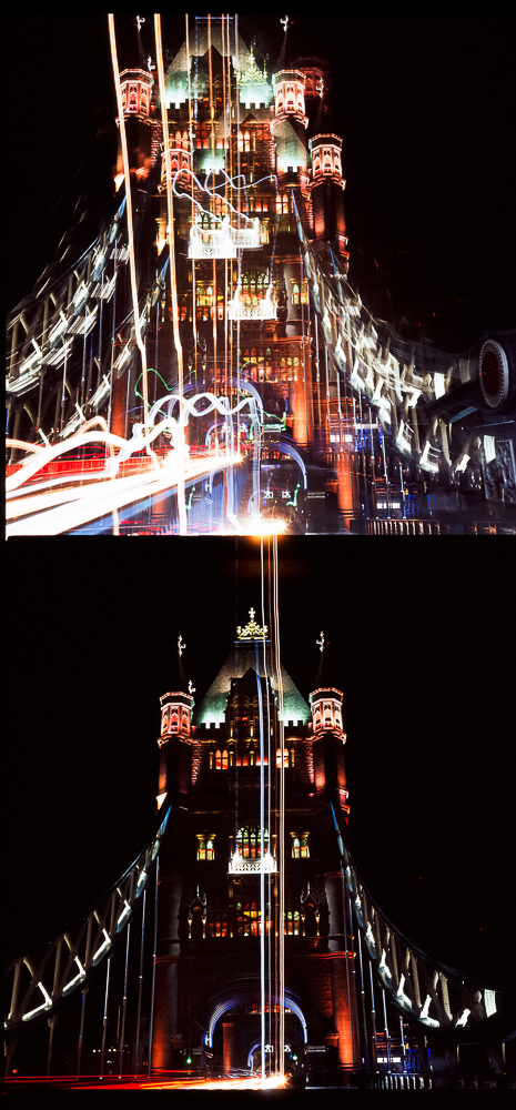

though i came across this while trying to do some bulb shots at night, not sure if its lightleak or the shutter release cable didnt release properly as It only happened on few frames. Any ideas?
edit: Actually i just tested it, i think the cable release is the culprit, sometimes the cable doesn't release all the way and the shutter is kept open doh!:bonk::bonk:
