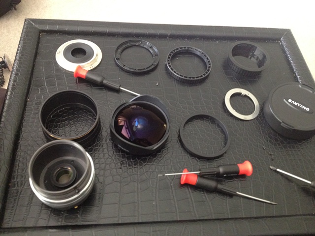

Took about an hour to do, I might need to re-open it to clean out some dust and possibly tweak the focus slightly but its not bad

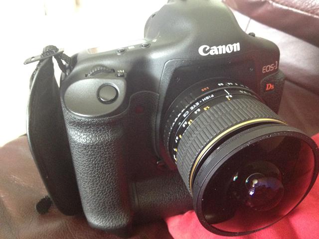

via this:
to this:

If you're competent with fiddly screws then not too bad.
There are very few moving parts so it's pretty simple, there are three tiny tiny screws for the focus ring and a teeny ball bearing which provides the click stops for the aperture but other than that!!
The hardest parts were:
1. Sitting the aperture ring back on the bb, it likes to fire all over the shop
2. Making sure the rings all ended up back in the right place! The first time I messed the focus up but it's easy enough to correct!!

Didn't think about taking a before photo on the 1d!!
I was tempted to leave the bb out as it was a pain, but it's obviously handy for stills :-D
