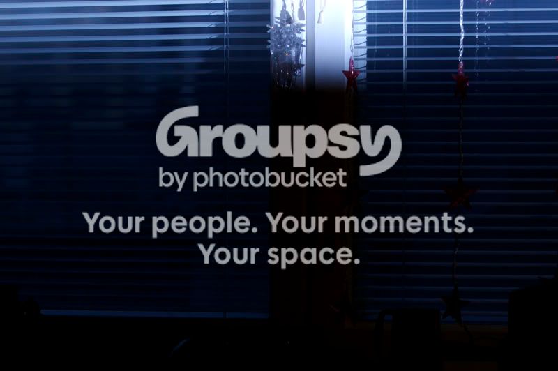

I have just received a cactus v2 radio trigger today and upon testing it out it appears to be doing something weird to my 30D. Here's a sample pic, its our apartment window with the flash gun aimed straight at it.
I'm getting a huge black shadow across the images I take leaving only a small portion of the photograph visible. At first I though it was the position of the flash but eliminated that thought with moving the flash around a number of times.
When I remove the transmitter and shoot everything is as it should be. I've tried hooking up to the PC/SYNC socket and attached transmitter via the hot shoe and still this happens.
I know these triggers are cheap and unreliable but I've never heard of this happening before. Could it be a faulty transmitter? I havent a clue!
If someone knows anything or can help me out I would be most grateful.
Thanks for your time
All the best.
shutter speed 1/500 no chance!
slow it down max is prob around 1/200 or 1/250
what's happening is the flash is firing before the curtain is fully open
and at higher speeds the 2nd curtain departs before the first has arrived so you get a travelling slit!
QUOTE=mmcp42;534355]shutter speed 1/500 no chance!
and at higher speeds the 2nd curtain departs before the first has arrived so you get a travelling slit![/QUOTE]
Mike your a champion and I am a muppet. Works fine now. I was so excited to try it out I think I just went a bit peculiar. Thanks for such a speedy response and taking the time out of your day to help a puddin.
Cheers again mate.
