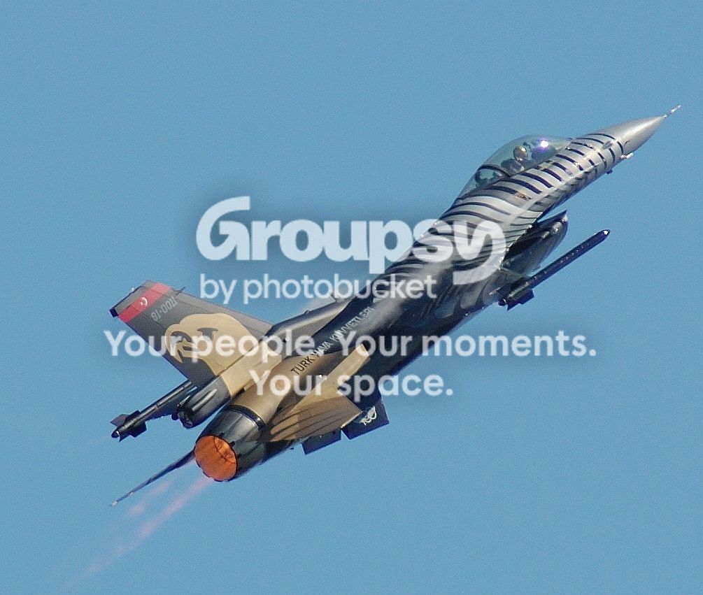

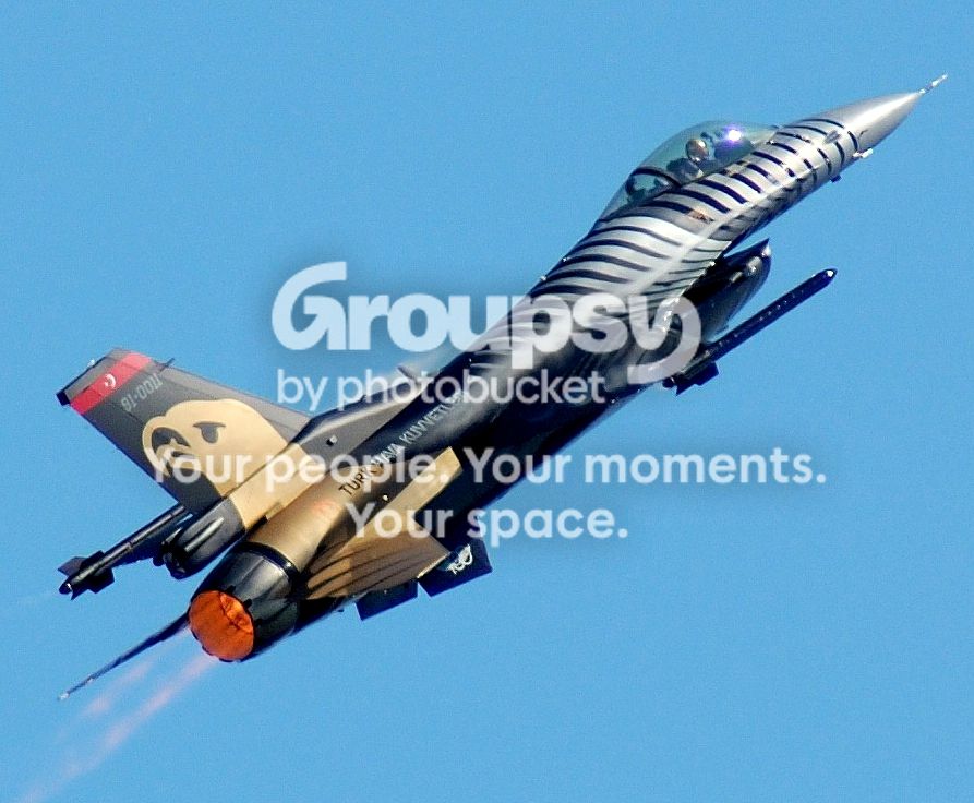

Thanks for the replys, reason for using ISO 200 is its the lowest setting on the D40x. I have been using exposer compensation as even on a day with a bright blue sky I have to play around with the photos to get the colors looking how I want them. Top shot is the original and the bottom one has been edited to get it how I want it looking.

Why are you using exposure compensation? The only reason I can think is that the jet is against a really featureless, bright, cloudy sky, then yes, the meter may want to under expose the plane... but if against a blue sky, there should be no need at all.
Taking the shutter speed higher should not make the exposure duller if you are also adjusting your aperture to keep the EV value the same. Are you using shutter priority? If so... it shouldn't make any difference to the exposure. If on manual... you have to adjust the aperture as well as shutter speed... you can't adjust one without the other. I see no reason why a speed of 1/500th or so should be causing you a problem. On a bright day though, getting 1/1000th or so shouldn't be a problem, and it helps negate any camera shake with long lenses. Jets are easier, as you need slower speeds with piston aircraft as the last thing you want is to freeze the prop... it looks awful.
It must be said, that's a very nice shot even before processing. It's plenty sharp, you don't need a faster shutter speed.
It looks to me like you're just trying to boost contrast and colour a bit, which IMO you've overdone a little. Can you walk us through what you did in editing? I suspect you're overcomplicating something.
One last thing, base ISO on the D40x is 100. On the D40 (no x) it's 200. Which one are you using?
Once again, very nice shot. I'd be proud of that.
