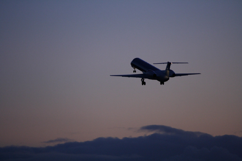

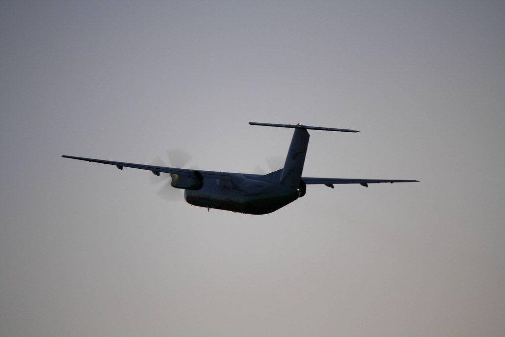

It got darker a lot quicker than I thought, so I was soon shooting in much darker conditions than I intended, meaning the only useable photos tended to be silhouettes against the sky. I also ended up shooting from a different position than I wanted but thats another story.
(1/100, f/5.6, 131mm, ISO 640)
(1/100, f/5.6, 250mm, ISO 250)
(1/100, f/6.4, 250mm, ISO 800)
I shall have to go back when it is a bit sunnier and hopefully can get some better results.
Mike, they were all shot at 1/100, and I think I would have struggled with anything less than that due to the general lack of light. I am right in thinking, the more ambient light about, the more I can cut the exposure time whilst not affecting the aperture.

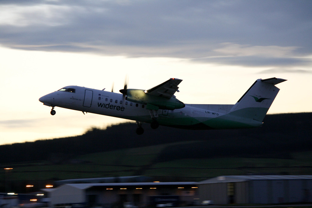

Another hugely important factor is to use the light you have as well as you can. If you're shooting aircraft in a dull, uniformly grey sky (as we in the UK often see!) then there may simply be no way of making the images look pleasant. Regardless of how technically correct the exposure is, if the fuselage is blending into the sky then it's probably time to pack up and head to the pub! If you do have some light then try move around the airport to find a spot where you're not shooting into the direction most of the light is coming from. The little Widerøe Dash 8 is quite backlit, so there's simply no way of exposing the aircraft without severely blowing the sky. Had it been shot from the other side of the runway the light would have been with you, making exposure much easier. This can be a massive pain in the bum but as aviation photographers it's just something we must accept and live with.
Yeah, had I been more forward thinking I would have setup across the other side of the field. The location I shot from here is the same one the photos in my "Aircraft 2nd Attempt" thread, but for the other shots I took them in morning, rather than late afternoon so it seemed to work okay.
