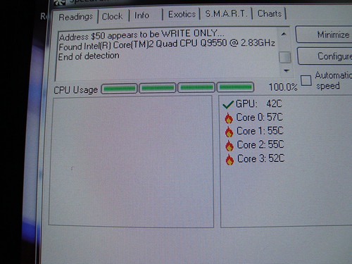

Speedfan is a great free tool to monitor all temps
