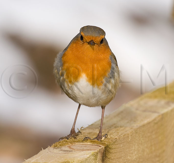

Now, interestingly, I went out on Monday and took quite a few pics and it seems that the lens is improving, as this robin shows

In between these pics, I cleaned the contacts and the filter in the filter mount, although it didn't look dirty, so maybe that helped too.

Didn't want to upload too large a picture on here, but on the original, I can clearly see that the place where the focus is sharpest is where I have put the arrow, while - as I stated - I focussed on the goose's breast. The robin was much closer and again I focussed on the breast.

I would wait for some really good light and do some further testing. I would say the goose picture is lacking detail rather than soft, but the robin, taken in better light looks fine. You need good light to pick out detail with any lens. If you try the lens at f8 in decent light, you may find that you dont have a problem.

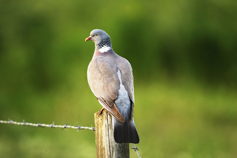

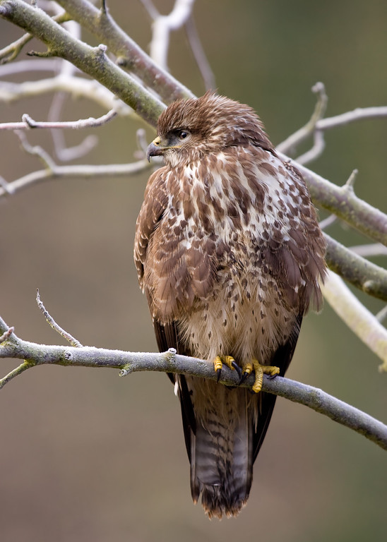

Here are a couple of samples of my 500mm F4.5.
1D Mark II - Sigma 500mm F4.5 @ F4.5
Also you need to be aware of the tiny amount of DOF that you get with this lens have a look HERE at 6m you get 2cm DOF and so on, you also need to have a solid base, my Manfrotto 055 tripod and Manfrotto ballhead were insufficient, when you fired it with the timer you could see the body/lens react, I ended up using a wireless trigger to set my combo off to minimize shake as much as possible. I ended up selling the ballhead and buying the Manfrotto Long Lens Head ( gimbal ) and that made a huge difference.
