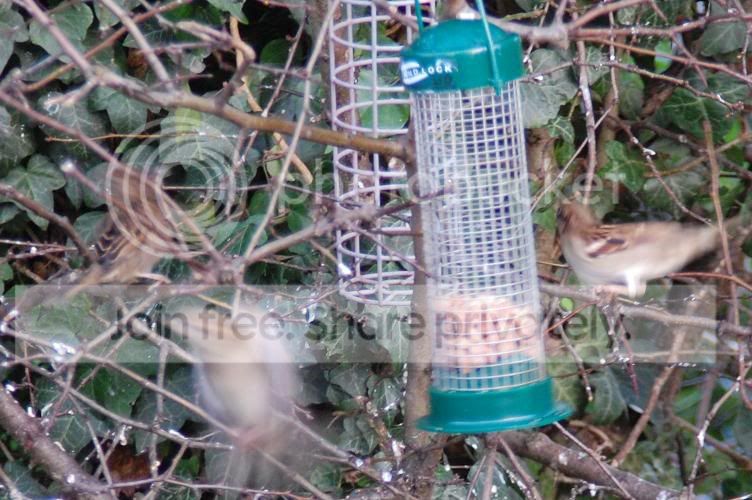

As Peter said. I just got my self a used tatty super cheap 2x TC and it works but auto focus is slower. I was shooting today there was a clear sky but found my self annoyed with the slow shutter speed I had to use even shooting at ISO 800. The little birds would not stay still long enough for a exposure so most of the shots the birds came out as a blurred mess like this.
I did get the odd ok shot you can see them in this link http://www.talkphotography.co.uk/forums/showthread.php?t=185662
