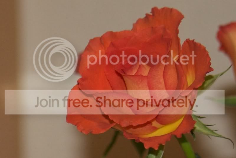

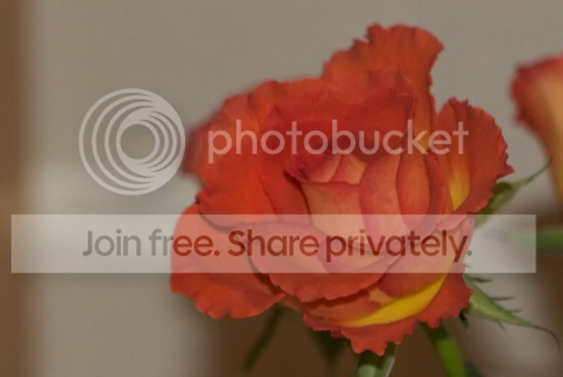

Crop from two raw files. No other pp.
Canon 24-70mm f/2.8 L
Canon 55-250mm f/4-5.6
both shot at 70mm, f/4 and 1/200th second; ISO 400.

Try testing the lens on something flat, I think I paid about £70 to get a 24-70 calibrated when for no reason started back focusing by about 18inch and no it was never droped.;)
Not a conclusive test macmike, but not a promising start is it. Shoot something distant to minimise focus error from the equation. On the bright side, one way or another you can get it repaired to 100% excellent :)
