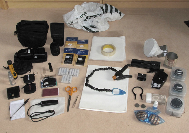

I haven't decided yet about how to carry stuff around in the field. I keep the camera on the tripod at the moment, including when travelling to and from sites. I expect I'll do the same here, with the 100L attached as this is likely to be the lens I use most of the time for closeups/macros (or the 10-22 when going out for sunsets etc).
I'm thinking I might get an aluminium case, but I do have a collection of bits and pieces in my backpack that might not go well (or at all some of them) in a case, and so if I can safely carry the flash unit and lenses in the backpack that is what I may well do. Don't know what I'd pack them in inside the backpack though.
