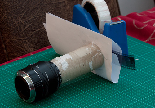

This whole experience has been an exercise in "do-it-as-cheap-as-you-can". Must be something to do with the 70-200 recently purchased.
Anyway, I built myself a scanner this afternoon in about 20 minutes. For some reason, a 20mm extension tube on my nifty is perfect for working with toilet rolls. Also, the 52mm filter diameter is the same size as a toilet roll tube. Go me!
