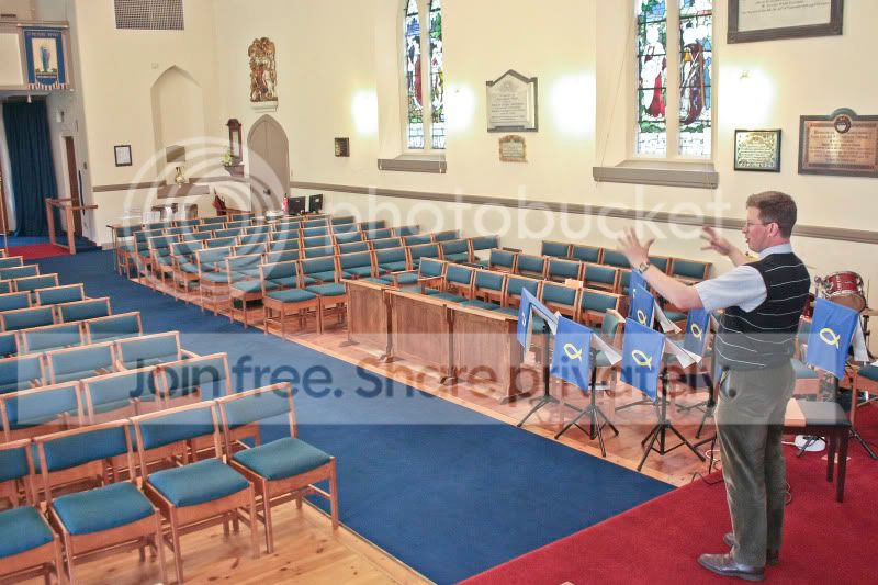

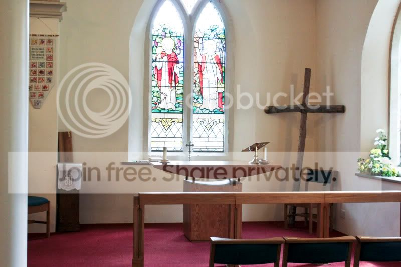

Here are a couple of pics in the church. The vicar is indicating where the
B&G will be standing. The other pic is where the signing will take place.
Both taken with the 18-55mm.
The second photo looks like it is OK with the 24mm, the first is at 20mm.
The top one could be a bit tight, if you want to get the Groom's family, and the band in at the same time.
First off, I thought the church looked nice and bright. Then I noticed the hands, and looked at the exif. Speed was 1/40 at f/4. Ouch. I suppose if you get them whilst they are singing, then they many not be too blurred. f/2.8 would take you to ~1/70?
