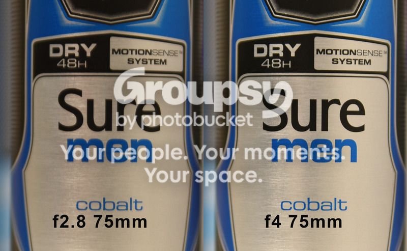

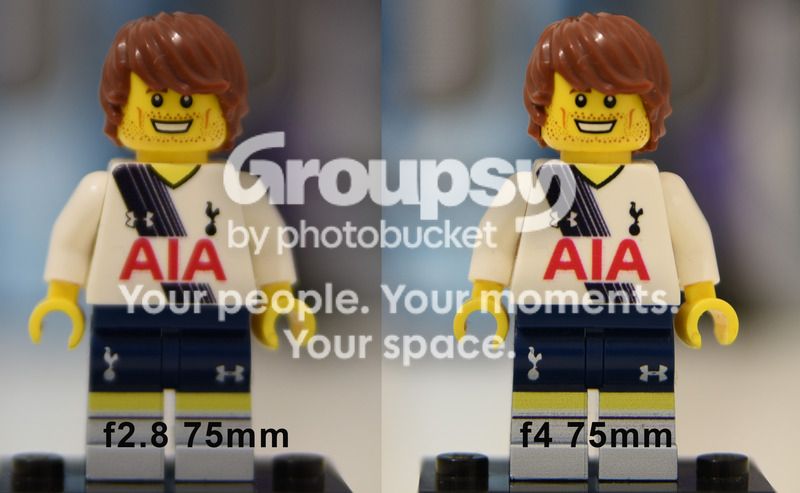

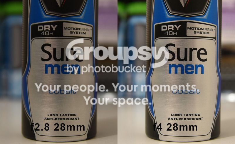

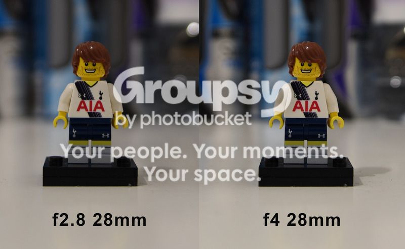

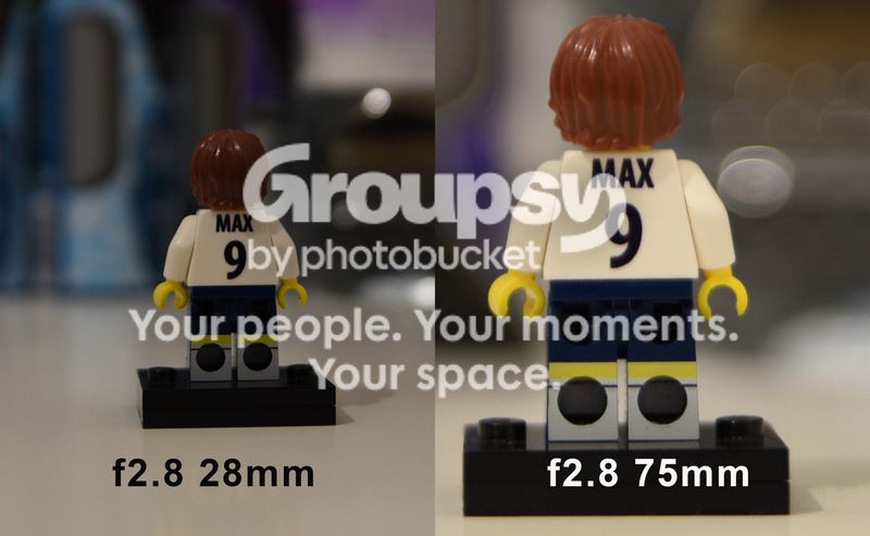

So I have on loan a 28-75 Tamron. I know that this lens has good and bad copies but how do you test for focussing issues and sharpness. I'm pretty uselss as the tech side lol. Before dropping £££ on the VC version I thought this was worth looking at first.
I don't want to commit to this copy if its no good.
Below are my initial test shots at 100% crop but slightly resized.
Difficult test subject, maybe should have used something bigger?!
What does everyone think? Any better suggestions on how to test and how to check for front/back focus?
Was focussing on the eyes, but it looks like the hair might have been caught in focus. The focus point was only just smaller than the head!
They don't look too far off from my experience of the lens which is that it is a little soft wide open but otherwise very sharp.
Difficult to tell if it is front or back focussing as as there is no depth to the target, Google will show you many ways to do this.
Thank you. Found a couple of things on google to test for front/back focussing so will give that a go.
I'm not sure what kind of results f2.8 should be giving, or if the VC version will produce sharper images. Obviouslt my test subject was on the rather small side and might do some more life size image testing.

Have they had any sharpening at all? D750 files sharpen up really well from my experience so apply sharpening as you normally would.

No sharpening - just straight out the camera and cropped. Its hard to compare it against anything else as its currently the only zoom I have. Will find a better subject and try again tonight or tomorrow. In the mean time I might accidently order the VC version to compare. Only downside is that the VC version stops me buying any other lenes for the time being!

I've used a few of the Tamron 28-75 and I agree that the performance above at 2.8 is consistent with my own experience. Basically it's pretty soft at 2.8, sometimes barely usable. f/4 and above it's a great performer.
Overall when you factor in the price it's a great lens for the money but outclassed by the newer Tamron 24-70 and of course the Nikon mid range zooms. The 2.8 on the 28-75 comes in handy for those OMG moments but it's not something I'd use it at if I can help it.
