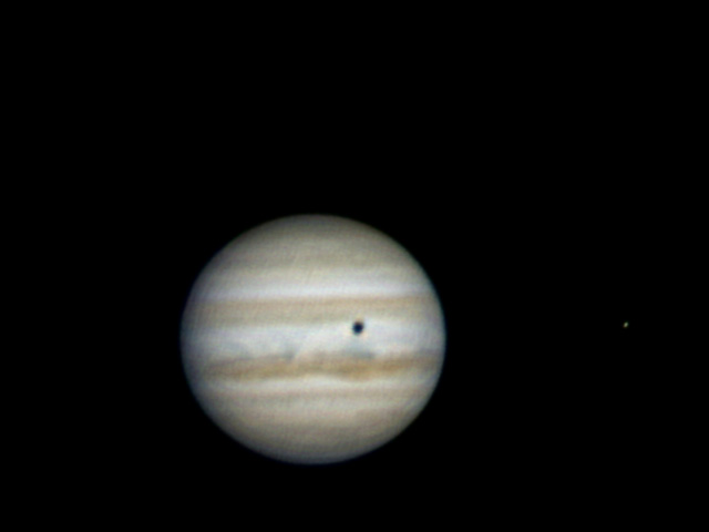

Moon is easy. Any scope will do, but planets are a really steep learning curve, not to mention needing longer focal length scopes, and cameras with much smaller sensors to fill teh frame properly. Most astronomers actually use webcams to image planets otherwise they are very small within teh frame.

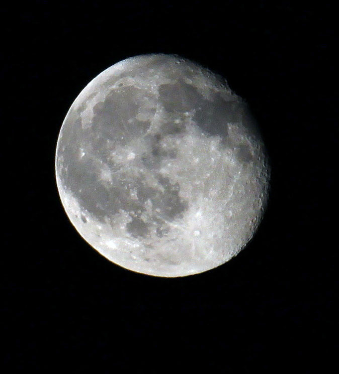

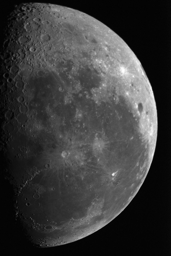

I would also recommend the Skywatcher 150P and a basic EQ3 mount that’s how I started. These pics were taken with the 150P and Nikon D5000.
