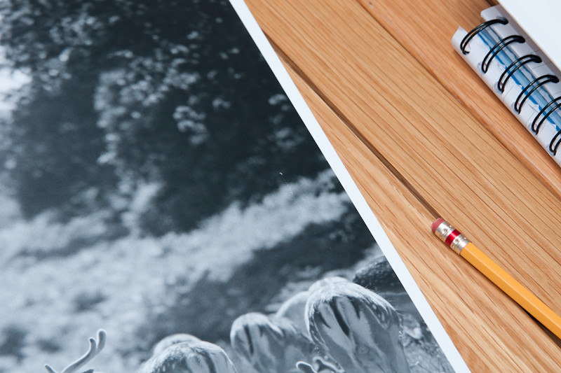

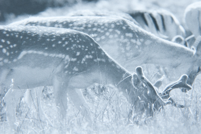

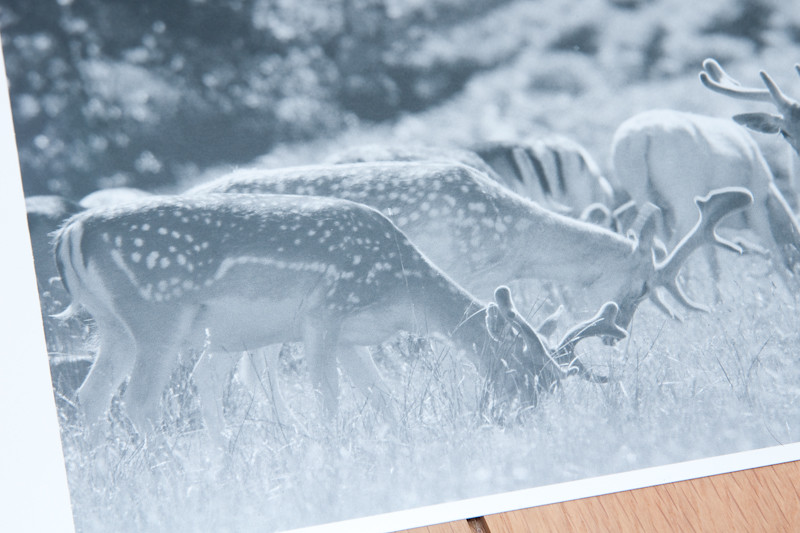

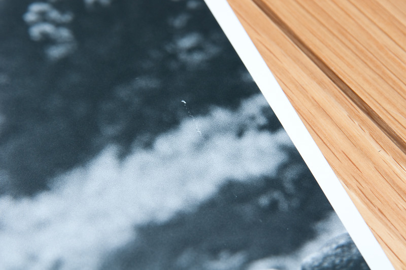

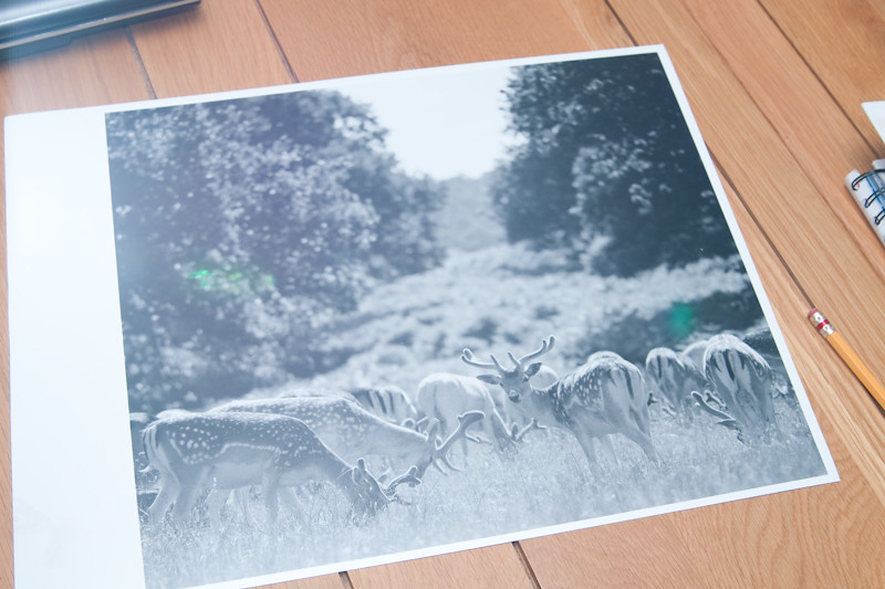

Just to illustrate the problems I've got here's a few pics of the print.

I've repaired far worse on prints than your marks there with spotting, so it's certainly do-able.
From that peek of the print, I'd say it's well worth the investment of the time needed.
