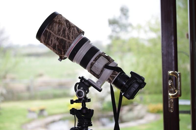

Here's the RRS holding a 7D, 300 f2.8 and 2x TC - and it's held there. A similar shot with the Manfrotto would be impossible - because the lens would be drooping (although it'd be moving faster than just drooping.
I take your point Frank, but you could slide the lens forward at least a couple of inches on the plate, which is what long lens plates are for, and the weight would be dramatically less. You could get perfect balance, zero torque on the head, and it would stop your tripod trying to fall over.
By the same token, the RRS monopod head is rated at 34kg - nearly four stone, the weight of a fairly large dog - and it wouldn't take that at the same angle. And neither would your Acratech ball head, which is rated at 11kg (I hope you don't actually use it like that!).
Nope, that setup is perfectly balanced. It looks like it isn't because the TC moves the centre of gravity back quite a lot. If I moved the lens forward it would be front-heavy. And it's impossible to get zero torque, because the centre of gravity of the setup is above the centre of rotation of the head. Even with a perfectly balanced setup, as soon as you tilt the head you lose that balance. Which is why the Manfrotto droops.
