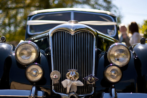

4. Not the groom!
Jason and Sheena Wedding-503 by AgentOrange71, on Flickr
