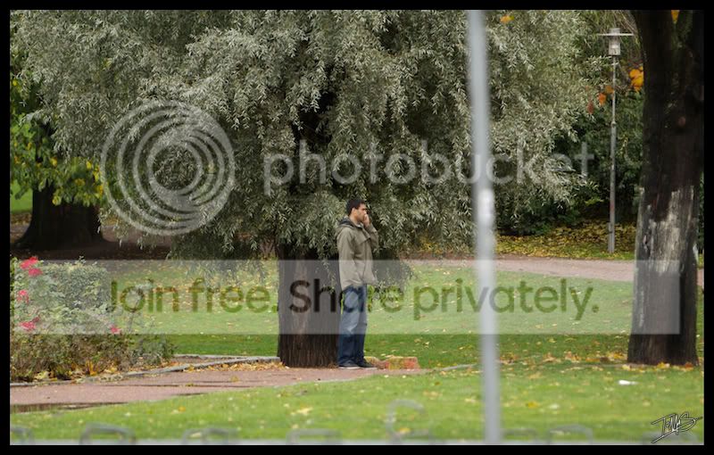

Certainly:
The first one! The center AF point was right ontop of the chap, it lit up and beeped signalling it's AF success but it's the tree's that came out in focus.

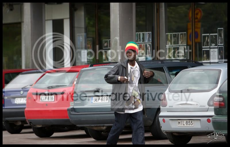

Number 2: Same thing, the cars have more edge instead of the subject, despite the subject as being the point for successful AF.
I've found a few scraps of info on the net regarding some copies of camera bodies or lenses suffering from 'back focussing'. Maybe that's what it is? Or could it be me?

It's hard to say for certain what's happened. What AF mode were you using? One Shot? Servo? Was the IS turned on? The second shot it looks like the AF locked onto the the car before the guy walked into the centre. The first shot looks a little soft overall, maybe a 100% crop around the guy's head would help to see how OOF it is. Front or back focus issues are normally less severe than this and if it was the lens I think your friend would have noticed the problem anyway.

In normal use for shots like this you want to be selecting just one focus point so you decide where the camera focuses on. However, I can't really see any evidence here on which to doubt the AF system of your lens at all.
Looking at the first pic, you've chosen a totally inadequate spot on which to attempt to focus. I've marked the centre AF point pretty accurately:-
That sleeve doesn't contain anywhere near enough contrast or pattern detail to focus on other than the contrast between the shadow and none shadow areas. Were it not for the shadows there, the AF system would hunt back and forth all day trying to focus. I'd have gone for his face, his hat or even his T shirt as being better AF points. The other thing is this shot will be softened just by being reduced to web viewing size. A bit of sharpening makes the shot far more presentable?
In the second shot, the AF point could be better placed, it looks as though you could well have got the gap between his chin and his hand - in other words the system will struggle if it has two planes in the AF area - his chin and the foliage visible through the gap.
Just lifting the AF point to cover his face more would have been better, but again, just normal sharpening makes the shot a lot better.
Hi and thanks for all your input, earlier this morning, a canon service center in helsinki diagnosed my friends lens with a back focussing problem and now it is going to be adjusted.
