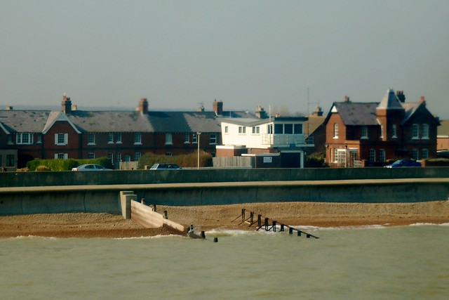

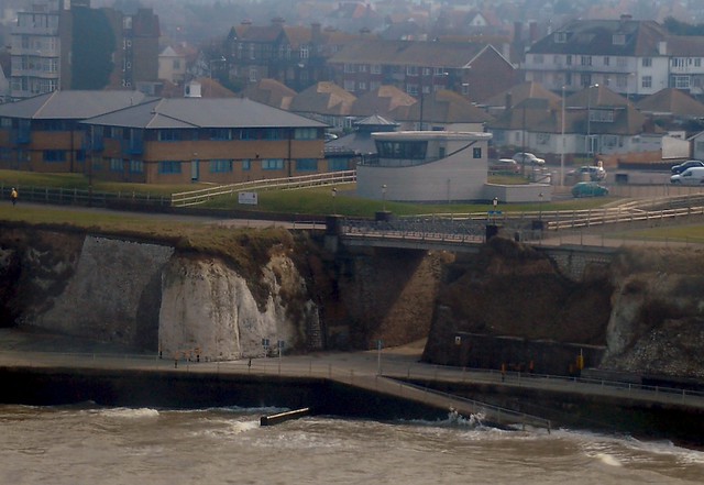

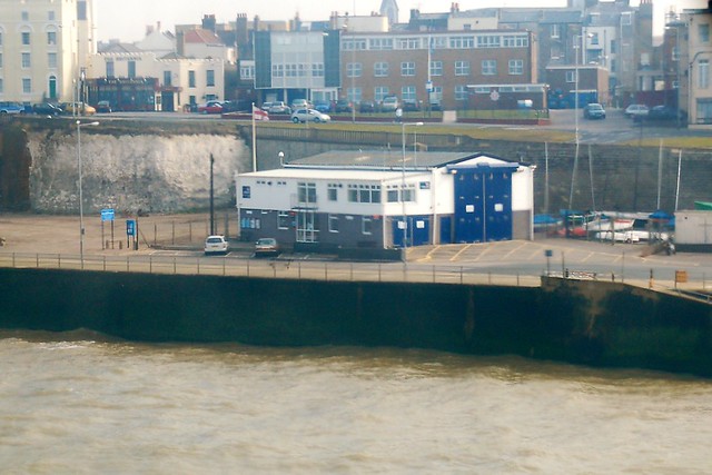

So heres a few that I took. Of course I was in the passenger seat!
Margate Lifeboat Station
Margate Coastguard Station.
HM Coastguard, Deal Sector Base ( my office at the time)
As you can see, they are not the sharpest due to the vibrations and I had to enhance them because the side windows were pretty dirty, scratched and cloudy.
