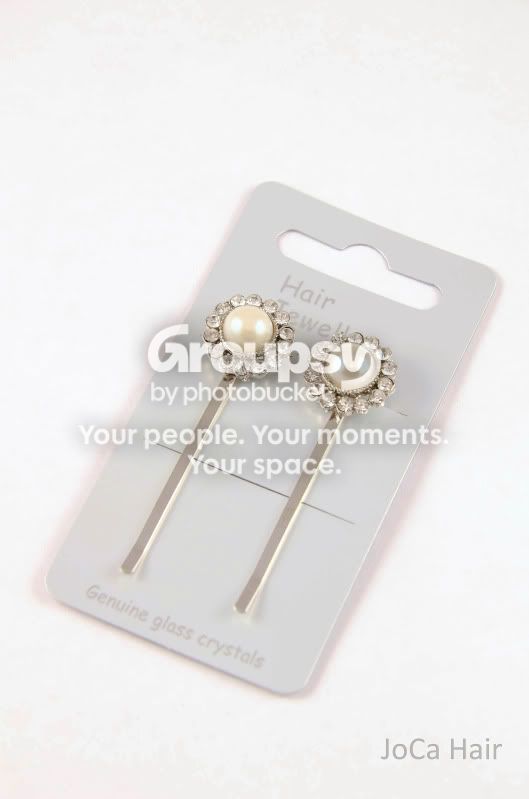

This is an example of what I'm able to achieve at the moment...
VR off, Focal length was 92mm @ f11 and 0.800s exposure time. Over exposed by 1 stop to help with the background. I have also applied a degree of sharpening in photoshop using unsharp mask (amount 100%, radius 2 pixels, threshold 1 level)
Very nice, a very good illustrative photo (and nice and sharp!).

Turning VR off made a big difference and was a bit of a school boy error on my part! I should add that I'm currently using AF fine tuning on the 18-105 and have it set to -10. Jessops are going to let me swap it for another one, so I'll see if that works out of the box as it should, without any fine tuning.
