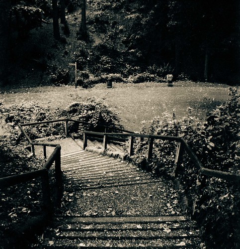

Here's a shot from Ektar 100 (converted to B&W in post), that had to be 3-4 stops under-exposed and it still looks fine, i could have boosted the shadows more if i wanted but it would have ruined the look i was going for.
Under The Bridge by Morinaka_2010, on Flickr
