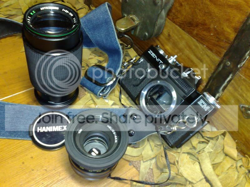

here's my Zenit:
I've just about sussed all the dials and alike, I'm using mine as my main camera (B&W and Colour) and I'll be persevering with it for a fair few months to come!
