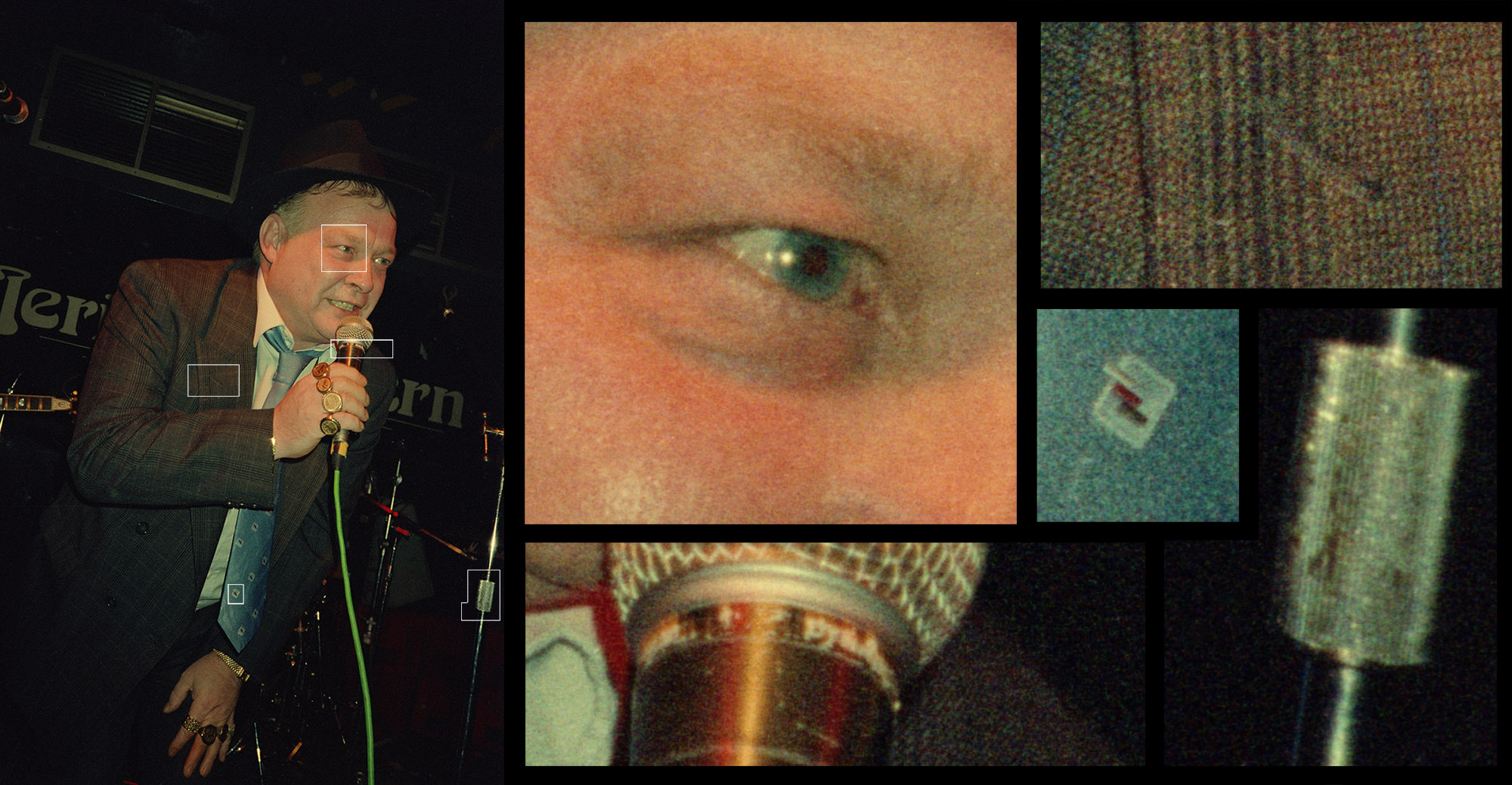

This is a 6000dpi scan of a frame of Superia 1600 taken on an OM2
The advanced CCD array and XY zoom mecanism help the Cezanne Elite attain its remarkable 589 t0 5,300dpi range of scanning reolutions across the entire scanning bed.
By all accounts it does actually meet those figures in real tests.
