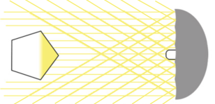

This is part of a drawing I made many years ago to help explain/show why "soft" modifiers become "hard" when used from too far away... and using your reflector from too close may be part of your problem. But the primary shadow edge is already fairly hard; it's just that the shadow edges have been lightened with "bounced fill."
But you can also see all of the light which goes around the subject... in a small/light room that light is reflected back into the subject, and the walls/ceiling/floor become part of your modifier/reflector. This is actually how/why a lot of beginners get soft light results in small spaces with cheap/small kit; a lack of control of the lighting.
This shows a reflective umbrella, but the specific type of modifier doesn't much matter.
To get the result you want you need two things. As hard of a light source as you can generate (small/distant/focused/etc), and control of whatever spill that source generates (no side walls, black flags, etc). In your case the best bet may be to make as small/hard of a source as possible with minimal spill. I would probably use as tight of a reflector as you own (e.g. snoot), and then possibly restrict that farther (grid/etc). One way is to make a "pinhole" mask from foil over your reflector... you will waste a ton of light, but it will/should work. The best way is probably to use optically focused (collimated) light.
